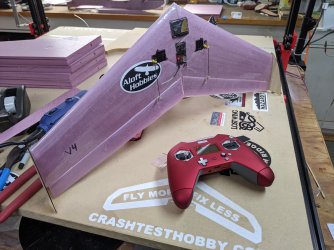

This is packing tape on pink foam
This is what I use on all foam
