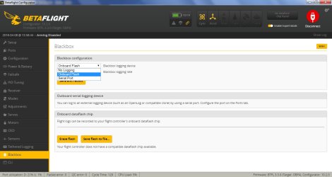

Just got around to putting the XSRF4PO Flight controller I ordered a month ago from Aloft on the bench today. It is a very nice controller, but I am not able to use the Blackbox feature. It seems that the SD Card is not being recognized. Usually in the pull down tab of Betaflight (Configurator: 10.2.0) it shows "SD CARD", but that does not appear. Of course, it says, "no data flash chip found" as this board relies on the external SD card for black box.
This is a Kingston 16GB micro SD card that I have used successfully with other flight controllers like the excellent Matek F405-CTR, and I had no problems with the Blackbox feature. I have formatted the card in WIN7 and have no problems reading or writing to it, but that did not work either; I have tried other cards, with different capacities, and no joy there.
Any ideas? Bad reader?
Nick
