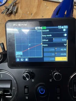

I’m not sure I understand this. I tried to assign flaps to my Avanti FMS jet. I’m using the latest version of ethos. I did a free mix for flaps and when I attached the battery with no other changes, he flaps immediately dropped. I watched several videos on how to do flaps. Their curve which they use for flaps was completely different for mine. I did not see at any time where their flaps immediately went down when they attached a battery. I was finally able to get the flaps to work using a different curve. I’ve attached a photo of my curve. I’m not sure why my curve is different from the ones I saw on the video.

The channel default should be 0. Did you look at the outputs? Were the flaps channel(s) at 0? I notice your curve is set to go from 0 to -100, flaps on all the planes I have setup use full throw, 100 to -100, or thereabouts, so if the signal went to 0 my flaps would be about halfway down. What is the range on yours?

Every plane can be different, so different curves and outputs etc are going to be needed based on how you have built and connected things. Heck I have seen 2 identical servos operate reverse of one another.
When you tunr on a new mix, it is going to move servos. Better plan on that, and they may well hit mechanical limits, you BETTER plan on that.
