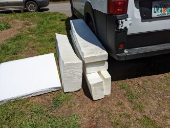

If u are ok with using the pink OwensCorning Foarmular NGX250, I found nice 8’x4’x 2” sheets at the HD pro store in Daly city.
Note: they were pre-scored to make installation between studs easier, which incidentally made it easier for me to re-size to fit in the back of my car in the parking lot while the contractors watched and laughed.
