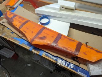

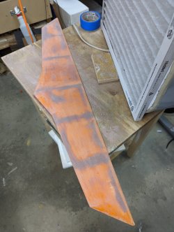

Some sanding and filling.
Epoxy and sanding filler. Super easy to sand. Hardens shiny so you can see low spots.

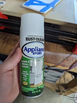

Careful - In the spray can world they are not shy about calling things epoxy that are not epoxy. Same with pretty much all paints at the discount places. Ran into this when looking to paint a garage floor.

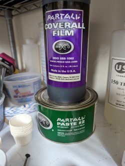

What will you be using for a mold release? If PVA, I think you could use just about anything. But when you start getting more exotic, you will need to pay very close attention to anything you put on your plug/molds to avoid very bad results, yes, even at the primer stage. Sadly I have seen many chemical reactions over the years, both with my own, and with others that are sharing their builds.

I don't know what mould wax or PVA you are using.
Bit of advice - if you know this then please disregard.
- PVA can be thinned down to 10% and still work very well and it sprays or wipes with a fine sponge much better if thinned.
- For wax I normally try to find the"TR" or "Partall" types as they seem to work and buff up a bit better than the others.
If you do get TR wax, then please don't be tempted to use the high temp stuff (unless you have to) because its really difficult to buff up once applied.
Couple of cents worth.

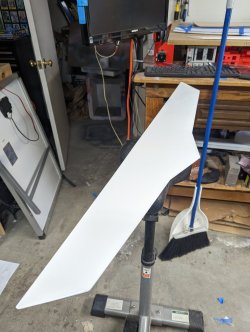

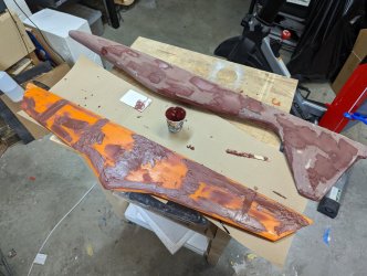

Minor set back as i had some bad interactions between paint layers on the bottom. Bunch of cracking and pin holes in one spot. Not a big deal but just more sanding filling. Was kind of odd as it was just a second coat of the same 2x grey primer.
Hi Nate - do you know, in all my moulding/plug making exprience I have never, ever, used primer. Not once in 55 years.
I am not sure why primer is even used on modelling projects.
Can anyone enlighten me?
