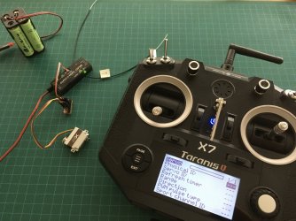

My first experiences with Xact servos are a mixed bag.
Discovering the telemetry sensors for a HV5611 was straightforward with a GR8 bound to my QX7 ACCESS. Executing the programming Lua script went without a hitch.
However, after setting the servo's Physical ID, Servo ID, and S.port channel ID all to 6, the servo does not respond to the channel 6 S.bus output. More worrying, it is no longer discoverable by the programming script. However, it does respond to a PWM signal, and the telemetry data seems to be active.
Have I now got myself a PWM-only servo?
Flashing new firmware to the servo did not fix the problem. I have a bunch more Xact servos but am hesitant to risk another one until I get a handle on the issue.
Any suggestions? Am I overlooking something? My sole reason for buying a bunch of Xact servos was for their S.bus capability. It's a disappointing start.

A knowledgeable user on RCGroups pointed me in the right direction: After programming a servo, it may be necessary to delete and rediscover all its telemetry sensors. It's a pain if you have a bunch of sensors referenced in logical switches. Anyhoo, that's how it works.
One other thing threw me for a loop: In the Lua script, it's necessary to 'select' the 'Yes' option for 'Save to changes to flash' in order to apply the changes. There is no other prompt or mechanism to save.
