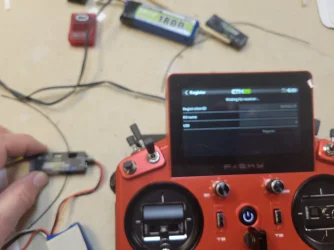

No Readme.txt but what does Step 5 really mean? I can't get to receiver factory reset of Rx because it won't connect over the air. 0 RF, blue LED. I can only bind with 1.0.10 or 1.0.11 preceding software. Then I get the other colors during reg/bind which end up green. Servos move. Should I connect by cable for the 3.01 update and remain connected? i.e. no OTA update from 1.0.x software to 3.01? I have gone back and forth several times. Can't proceed to Configure Stab if no bind. No RF.

I cant see anything usefull on the attached image.
The image just shows that it is an Archer Plus SR8 with a blue LED. More importantly, do you have an interpretation of what step 5 is all about? I think it's time for a Github issue to be written. If no one has any suggestions, thanks for trying. My knowledge is limited about this radio but I am resolving that daily. I'm currently under the opinion that the receiver is not compatible with the latest version of all the other updates.

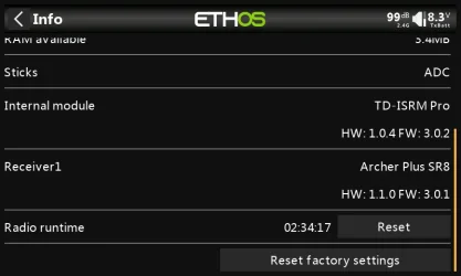

I have good news here, hope that I was able to recover my receivers. On FB someone recommended that I flash the receiver with the old software 1.0.11 by cable.
I did that and registered and bound it to a test model on the radio and checked Chan 1 for servo movement. Success.
No OTA. I then flashed it again with a new copy of the 3.0.1 software by cable. I did that making sure I was connected to GitHub server through Ethos and downloaded the new copy and after extraction I put the *.frsk file in the Firmware>receivers directory.
I was able to register and bind to the receiver. After this I checked for servo movement. Success. I then powered off and Cleared the bind for the model. I then powered up the receiver, selected RX1 and selected the Factory Reset option. This is recommended on the FrSky Firmware download page, Step 5.
I Registered and bound the receiver again because reset wipes out Reg/Bind info. After again binding, the receiver worked.
Perhaps since my two receivers can go back and forth (by cable) I can recover from the dreaded Blue LED problem. I will now, after Factory Reset process, calibrate and configure in a real model. First to see it works on the bench and perhaps later, if it works while flying. Based on this, I closed GitHub issue. #5309.
