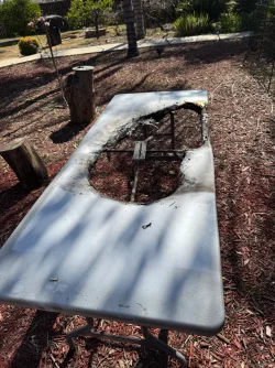

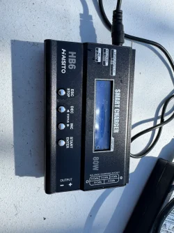

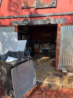

Today was a scary day which could have been so much worse. I have a small barn I build in and have been charging batteries in. Today a battery caught fire while charging and almost burned it all down. I have used this charger probably 10 times without issues. You set the cell count and voltage and then it performs a check and you push start. Luckily I am in the habit of checking about every 15 minutes but got complacent. In the past it has always shut off when done charging.
Went out to check and saw smoke pouring out the door. Opened the door to find my building table fully engulfed. Luckily with a hose nearby I was able to put it out. Lost a lot of tools and a plane under construction. The battery was the two cell one that Aloft sells in the Silly stick package. The charger was off Amazon. I have only myself to blame. I even had one of those fire envelops for charging but got complacent and did not use it. Seeking recommendations for a quality safe charger. Btw my wife keeps her Christmas stuff in this barn. Had it gone up it would be the end of my rc hobby. Be careful !!

As far as recommendations for safe chargers go, I bought this one off of Amazon and it works great.

My favorite charger for a very long time has been an i-Charger. It is not the easiest to use, it is not the best looking, but it has one thing that I wish more would offer, it has a temperature probe you can put under the battery while charging. If it gets too warm, it turns off the charge. Is it a cure all? Probably not, but I do think it is a good idea.
Generally I do trust the Toolkit RC, Hitec and ISDT chargers a lot. We have sold all of those brands in the past and not had any scary stories about them. I do not like CHEAP chargers. I occasionally use them around the house, but my trust level is very low. For example we have a cheap vacuum, and my rule is that it is never left plugged in if people are not around. Zero trust of that unit. The same goes for RC chargers. I recall when I bought the i-Charger is cost a lot more than the China specials, but the manufacturer made a big deal about using only grade A components. You simply are not going to get good components or quality control with a $15 charger.
