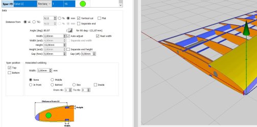

xtremware New User Dec 15, 2024 #1 Hi, has anyone tried defining a false LE?, it seems that you can adjust a spar to do the trick, but it is not a very elegant solution , is it? Attachments Clipboard_12-15-2024_01.jpg 104.4 KB · Views: 186

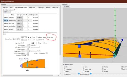

S Steve Labuta User Dec 15, 2024 #2 Use a Round or Cuboid type spar and there is an option to use it as a leading edge. These work well. Attachments Capture.JPG 124.9 KB · Views: 183
