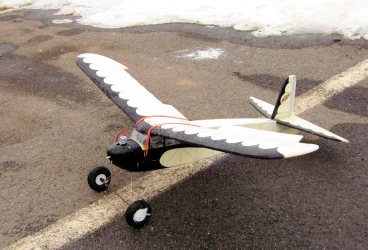

Could intentional use of RC fail safe reduce crash damage if loss of signal?
Yesterday a buddy lost a plane - after a few circuits of the field.
Apparent loss of all control functions, then spiral into the snow.
Picked up the plane, and everything worked again.
Often I have wondered, is there a chance, is there a possible instance, where invoking receiver failsafe
(control surface preset positions) by quickly turning off the Tx could ease the damage in an impending crash?
Glide down rather than spiral in nose first?
I have tested receiver failsafe on FrSKY receivers by turning off the Tx in flight and gotten the result expected:
with throttle cut, a polyhedral plane turns into a free flight glider. A little rudder preset keeps it on the field.

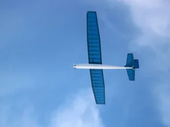

> I do not recall going into failsafe since using FrSky gear. Lucky?
My experience is the same with FrSKY.
In my test, I switched off the transmitter to see how failsafe would work in flight.
It worked as expected on 2-meter polyhedral with custom preset of: motor off, canted rudder, and a smidge of up elevator.
After watching for 8-10 seconds, turn Tx back on and resume flying as before.
OFB observer exclaimed "I would never do that".
Then he said, "But maybe I should."
