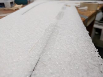

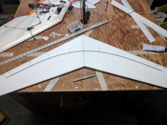

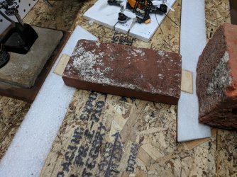

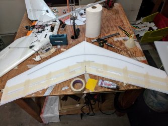

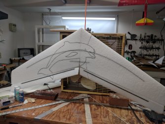

Carbon fiber rods installed top and bottom. I decided to try amazing goop as my glue. Pretty happy with the end result.
The wood inserts were a little finicky to keep in the precut hole, but i made professional "jig" to keep them in place :)

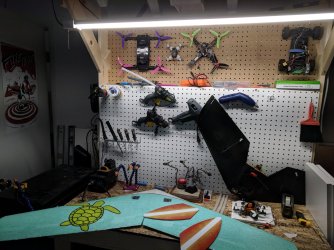

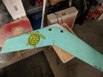

I needed a way to hold the elevons in place that i could also paint on them and the main wing. I watched a video on amazing goop hinges and tried it out. Was very easy to do.

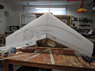

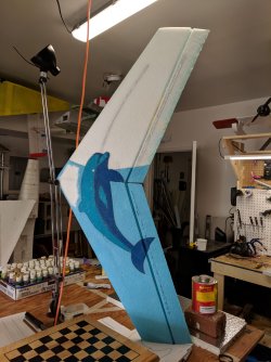

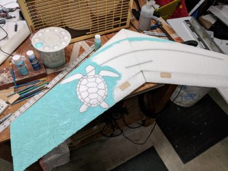

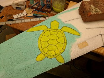

Using a projector i was able to trace some surfboard inspired designs on the wing and paint with some cheap acrylics.
IMG_20171127_211928.jpgIMG_20171127_211944.jpgIMG_20171128_080828.jpgIMG_20171128_205438.jpgIMG_20171203_120031.jpgIMG_20171203_120050.jpg

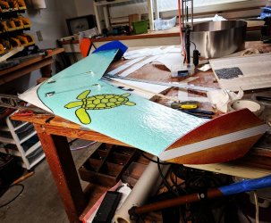

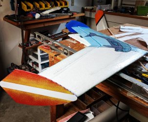

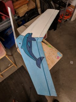

After laminating i went back over the designs with a thick paint pen (like a big sharpie).

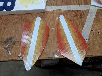

Quick wingtip paint job

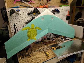

Almost done with the build
