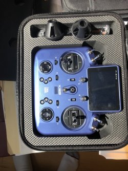

Well, here’s a real world indication of how much I’m liking this new radio and its new OS. I purchased another X18, after only programing 3 models! This time I got a X18S mainly because Aloft was out of stock of the X18 se ( the red ones). I’ve really only dealt with the basic aircraft set up and simple file management. I haven’t added model photos, really done any of the safety checks (other than fail safe), or any telemetry stuff other than RF strength.
On 2.4 gHz (X9D and DX9) I often flew into the RF warning. With the Tandem system I’ve yet to get an RF warning other than in range check mode. True I’ve yet to fly a 3 meter plus thermal ship on Tandem, but I have been flying these jets low (10 meter) and out to about 750 meters with the only limitation being my eye sight.
With Ethos you can still use real world logic statements when writing your programs ( just like you did with the Multiplex Profi mc and OpenTX). An added benefit is that Ethos also has a great start up wizard and prearranged mixes. This almost makes setting up simple models (most foam ARFs) to easy!
So the short of it, I love Ethos and the Tandem radio. Now between the X18 se and the X18S I can‘t see a nickels difference. Ok, my X18 se is red. It is looking like the X18 is the better value radio. I hope to be able to use the added memory of the X18S. As it is now my X9D is running out of memory. So I have high hopes that I’ll need the 512 mB of memory. I have to admit I see no use for the TX gyros. Maybe at a later date I can find a use for them. But as of now they are a feature I can’t foresee using.
As to the main interface with the TX, the gimbals, I can’t feel any difference between the two radios. In a blind test the only way I could tell which radio I had in my hands was that X18 has a gloss finish and the X18S indigo blue was a mat finish. My non-calloused engineering fingers can feel the surface finish difference.
