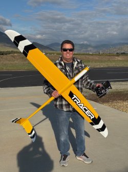

Ok. Here is proof. Still dialing it in.

Dang that looks nice! Was looking at the picture trying to figure out where you are flying and could not place it. I see you listed your location as Sanger. Looks like an awesome flying field.
Dang, that is a super nice field!
