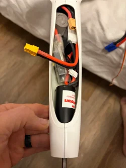

Hi guys, when I cut the nose off to fuselage, I cut a little angle down and a little angle to the right. I really didn’t notice a lot of difference in the way the way it flew. I did like to feel of the stall turns better with cg aft. I had to reduce my elevator throw. And no, it does not just go straight up during motor run. I usually don’t use motor on a straight line besides going up but I can without a real problem.

Hill - Most planes of this style will have no down thrust built into them to control the climb under power. The amount of down thrust that would be needed would require the nose of the plane to be pitched down as some of the LONG geared inrunners people want to run can't be "angled" in the fuselage to achieve the down thrust. This bent nose will cause you some drag at speed. I personally just adjust my elevator input as I am flying, no mix. I'm not a big fan of mixing for this application. Some folks like a stabilized receiver to control the pitch change.
Wayne is right. The nose is already down by 1.5 degrees,
