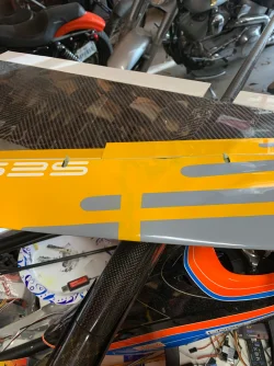

Hummmm
Till I can learn to paint 😜

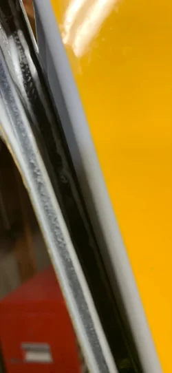

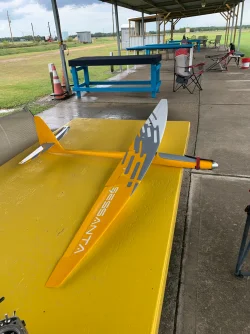

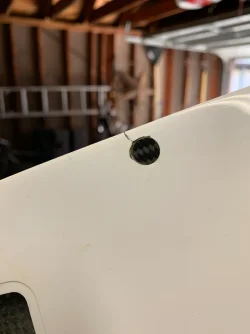

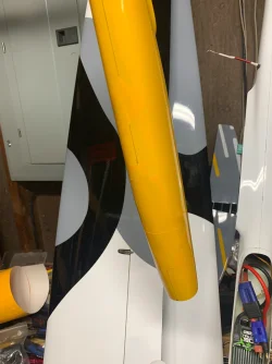

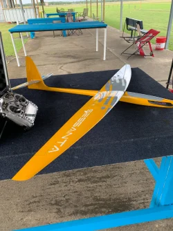

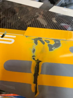

Well the smooth release of spars made for easy repair. The crack was only in the outer FRP layer the foam and the inner foam good. I put a 64th birch plywood, doubler inside. Stop drilled the crack, lower side of leding edge.

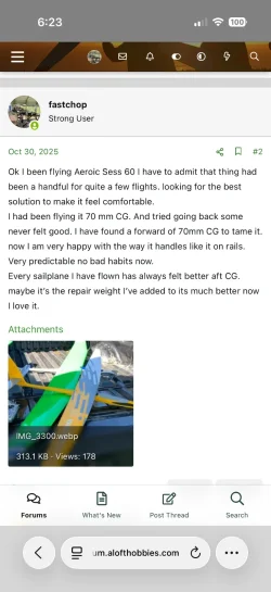

Hi smirk, with Mine CG seem to be the biggest issue for the stall once I got center gravity well before 70 it did smooth it up. Keep elevator throws low specially for up. I was having a lot of radio issues with the first generation Taranis. check through My thread flatlander few more updates in it.

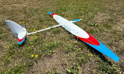

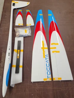

Good morning well I have to say losing my Sessanta was sad. My other thread flatlander explain that if y’all have read through that one. I have a replacement coming could be an upgrade. It’ll be a Toccata. It Will be here monday. Yes it will be powered.🤭😂🤤

Hey Wayne, the grass pitcure is from your site, but the disassembled plane is from another forum. It was a good deal as far as the money and getting it to me. I will be sending you an order servos
