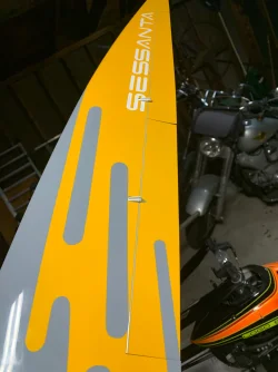

Well soon to be here take a look!!

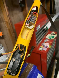

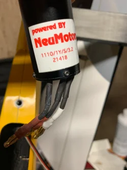

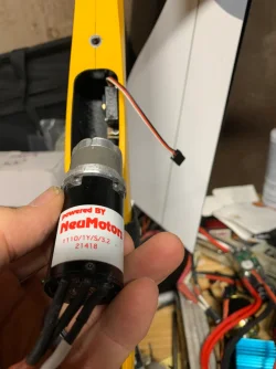

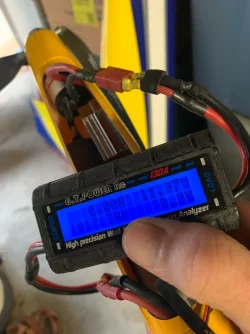

Power system Neu 1110/1Y 1000+ watts!! 3s 14x9 4s 12x7 1200 watts

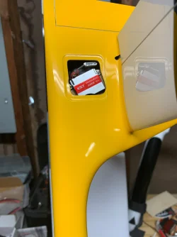

rudder servo under wing incase I have to get it out.

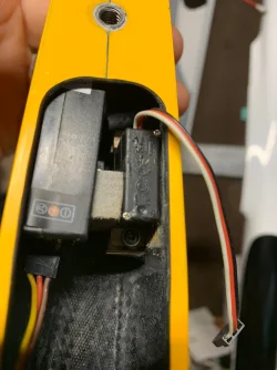

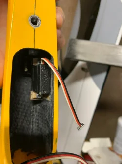

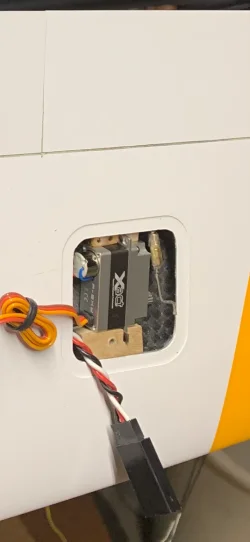

Hi Doc, I just thought that it would be a hassle, in the back most of the time I would shove it in the tail like I did on the gremlin had lots of room. The Corsa plenty of room elevator&rudder in the tail but I put my receiver by the servo so I wanted the control rod low in the fuselage so I have plenty of room for receiver.

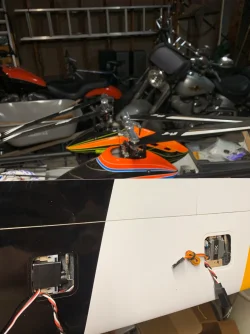

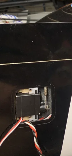

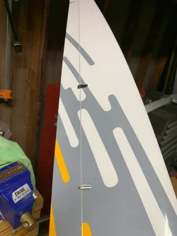

Just need to do servo horns

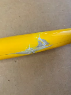

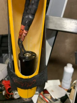

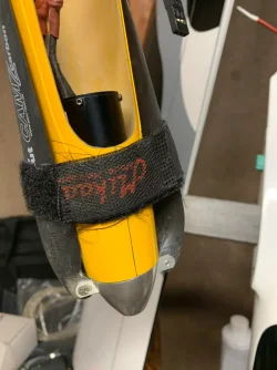

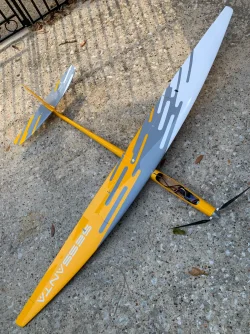

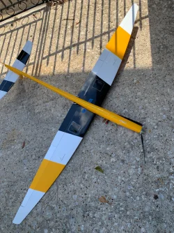

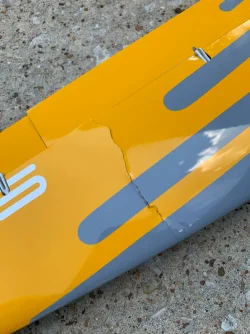

Well, the original motor was too heavy. I had to put a smaller motor in so I can balance it. The other motor needed like ounce and a half it the tail. I got a few pull on a smaller motor. The maiden went well, until it didn’t. It stalled dropped a wing I could not recover. The End
Beautiful airplane I’m sad 😖
That is not a good result. :( If you bought from us, shoot us an email please, we can try to work up a deal to help you.

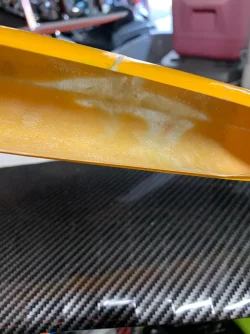

Interesting carnage on the top of the wing.
Last time I saw something like that was a guy who stamped on the wing to punish himself because he felt so bad for crashing the model.

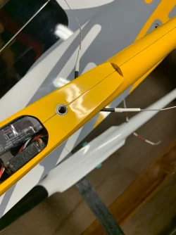

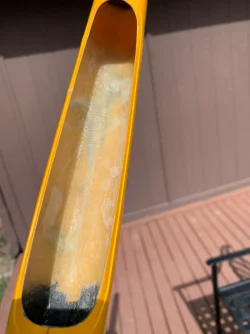

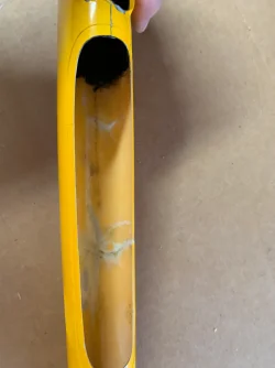

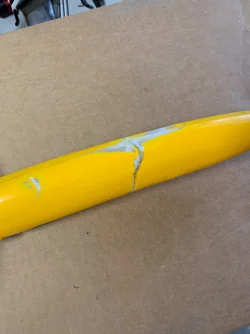

Fuse ca tacked ready for glass repair
