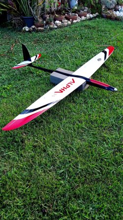

Hello everyone just want to share some pics of my E-Alpha 2.0m Build
The Quality of this model is top of the line and very well priced.
For electronics im using Corona Digital wing servos and mini for Rudder.
Emaxx Digital 17g for Elevator
Neumotor 1107/2.6D/6.7 P29 gear drive
Jetti ESC
Aloft Spinner and Carbon Folding Props
* Big Thanks to Wayne for always having great Products at reasonable prices...that keeps me motivated and wanting to build more often..* ?

The rear servo location is perfectly located and very easy for servo and rod installation....plus the Fuse is strongly reinforced both in front and back .....TJIRC Models looks to be better built and of superior quality over any RCRCM Model.....
Almost ready....just need to finish the radio setup ...and locate the CG...think it should be the same as in the Typhoon..?
