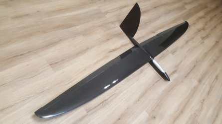

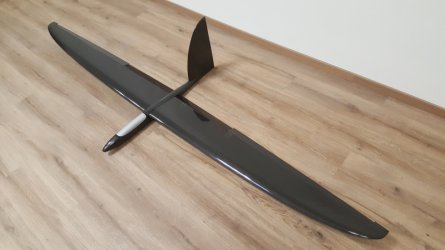

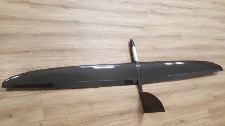

Another plank from Lesky Composites, the 2.2M Lesky Wing.
In terms of fast 'plank' planform flying wings - this one should be pretty quick by design. The aerofoils are by Daniel himself and if they are well designed to get the best out of the planform style, then wow! In the case of the very low sweep elliptical lift plank form, the aerofoils and wing shape are really ctitical to allow the MAC and the CG to be far enough away from each other to allow stable flight.
The close similarity in design between this model and the Amokka is obvious.
