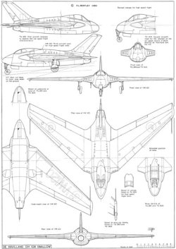

I think a fuselage moulded with a sideways seam line including those massive root/vertical stab fairings and plug in Balsa or other (Glass Vac bagged?) veneered wings and vertical stab would do it. Canopy section removable to allow radio access etc. With a good wing section and maybe flaperons? I dont think separate Ailerons/flaps would be easy to set up, but I'm not too sure. Any inputs welcome!

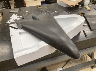

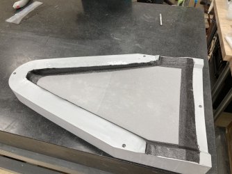

Doc, I split the molds on this one horizontally. For sure makes the layup so much easier, like a boat.
Gotcha - thanks Red. Like the DH 108 your BWB would be a bit of a PITA to mould vertically!
