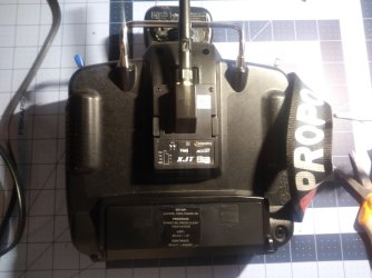

I’m posting a picture of a total reconfiguration of the XJT into a“XHT” setup to mimic the DHT configuration, including the bind- range test button /leds/mode dip switches on a dongle for remote location mounting.
Consulting with Wayne, he asked if the module could remain more Stock with only the bind/range test button on a remote 2 wire cable. The dip sw and LEDs staying where they are to make the conversion easier. The answer is YES!
If however one would want to externally change the mode from D8 to D16, that too only requires 2 wires and a on off switch, or 3 wires for both.
To remote the entire sw/led/button board requires 4 wires.
To power and input ppm, 3 wires are needed like the dht.
All easy to do.
The only difficult addition is adding a longer coax/antenna connector cable to allow more internal case location mounting in the older tx conversion.
I’ll be posting my so far hand drawings soon of the locations for adding a remote bind button and dip switch.
Or a complete removal and remoted sw/led/button board as well as the longer added antenna coax & connector cable.

Im doing this Monday. I ordered the XJT module and V8 rx from Aloft on the 5th & my donor transmitter is a JR XP7202. Im going to direct solder the 3 PPM wires to the board but leave the rest as is and mount the modue externaly and use the 72m antenna base as a support for the dashboard when Aloft gets them back in stock. After I am done with the 2.4 conversion, what is left for the module to talk telemetry between the dashboard, onboard sensors & the recivier. Thanks for your emails Wayne. Jay
Hi everyone, wow I see interest in the xjt conversion is happening.
The module data pins still work so I’m thinking just use them as intended.
Sent from my iPhone using Tapatalk Pro
I just finished mine. Works perfectly. I only soldered the 3 PPM connections and cut the back of the transmitter case so the XJT module will snap in just like a radio with an external module bay. I stuck a cheap timer on top thats just a place holder until Aloft gets the smart port dashboard back in stock and thats where itll go. Thanks guys for the support. Jay
