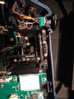

3. Replacing the machine screw in the left gimbal centering arm was difficult, as I tried it with the screw orientated with the head facing inwards, the way it was in the right centering arm. Three times the screw dropped in the tx, and I had to invert the tx and shake it to get it out, while not tugging on the antenna wire. Eventually I replaced the screw in the left gimbal with the head facing outwards, which worked.

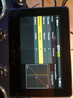

When I finished, I found the right (throttle) stick was fine, but the left (elevator) stick had a problem with centering; after an up or down control, not centering on the exact center, and being soggy near the mid point. If I move elevator up and let go, the position of the elevator is shown on the Tandem model/mixer/elevator screen, not properly centered (photo attached). I have gone back in and re-checked and re-adjusted the ratchet and brake bands, with all pressure eased, without solving it. I did a few flights, and the elevator is a problem.
Here is my diagnosis. In the Tandem the default is mode 2, which means when you convert to mode 1 the spring for the elevator centering has been pre-stretched. In my tx, this spring is now unserviceable. I have some old gimbals and I am thinking of recycling a spring to replace the spring in my Tandem. I would appreciate any advice on this procedure, after removing a spring, is it tricky to install a spring? Is there a replacement gimbal available for the Tandem?
