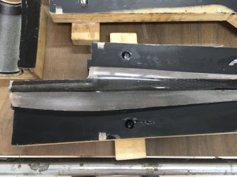

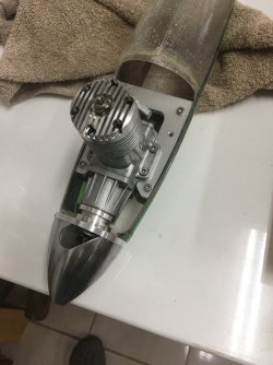

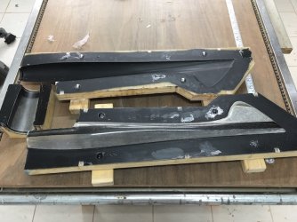

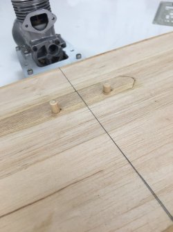

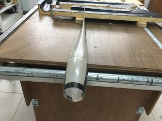

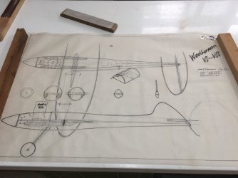

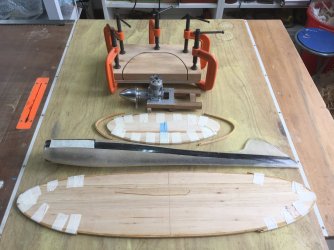

Anyway here is a new project I'm messing about with. Its a British "Weatherman" Class V-VI-VII photo speed model, similar to the USA "Perky" Class. The idea is just go as fast as you can from the getgo, but with a lot of vintage rules. Except the engines...hehehe.
Its good to go back to your roots and chop up a bit of balsa from time to time...trouble is you cant prevent a little technology creeping in!
Anyway this one is different because it has a glass fuselage and a carbon U/C.
IMG_6620s.jpgIMG_6621.jpgIMG_6624.JPGIMG_8251.JPGIMG_8252.JPGIMG_8262.jpgIMG_8263.jpgIMG_8266.JPGIMG_8269.JPGIMG_8270.JPG
Hope you like it.
Couple more pics.

wow James - such an awesome build - I too flew a simple control line when I was a lad - nothing as extreme are you guys, but I remember it fondly!
Its a bit topical Phil because the glass moulding is exactly what you are doing right now too. The only real difference is that yours are all computer generated where mine were all carved by hand.
