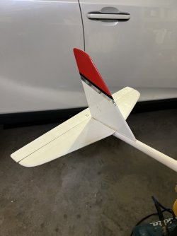

Wayne, I’ll be making a couple sets of horizontal and vertical stabilizers for ODR slope racer builds. Strength and durability is more important than weight for this project. Planning on ordering some of your new balsa sheets instead of taking my chances with the janky stuff at my local store. I’m wondering about the difference between your Contest Grade and normal grade- regarding strength and which type is probably less likely to warp over time. Guessing the Contest grade is lighter, but wondering if it’s stronger or maybe a bit weaker.
Wondering which type you think is better for this project. I don’t mind the price difference. And I know there‘s no certainty about individual piece quality, warping and just plain bad luck. Planning on ordering it in 3/16 and will sand thinner towards the trailing edges.
Any thoughts would help.
Thanks for sourcing the good stuff!!

Only use contest grade if you are looking to save weight, or make sanding really easy. I would consider contest grade as fragile.
You will want the normal balsa sheet.
With this said, you may want to check your local hobby shop as most people pick out the light weight stuff and leave behind the heavy gnarly stuff. I think this heavier wood will be perfect for your application. This could save you some shipping $. It is at least worth a look to see what they have.
Any wood can warp. I'm not a wood expert (we do have some here!) I think the main culprit is moisture changes. The thinner woods are very prone to warping. We use some thin stuff on our micro gliders. We just got a fresh shipment of wood, and all looked great. We keep it in the climate controlled part of our space, and after a few days we found the wood stack had taken on a lot of warping. We get a little mist of moisture on the wood and compress it under some weight, next morning back to perfect sheets.
We store our wood flat, but it is not good enough. I'm thinking we might cut up some heavy 1/2" plywood (or similar) to sit on top of the stacks to keep them from warping in storage. This is mostly an issue with the thinnest sheets.
Anyone else have a more elegant solution?
p.s. I see the same issue when visiting lumber yards. I do wonder how much lumber gets trashed due to warpage.
Appreciate the advice!
A build idea…. a sloper I know carves out a strip of the balsa horizontal stab about 1/3 the way back from the leading edge, just wide enough for a strip of basswood. He glues in a basswood strip for strength, but it might help with long term warping too. A spar of sorts. Could use a thin carbon rod buried in a trough for the same effect.
When i get the balsa I’ll keep it pressed. It will be a month or so until I start the builds.
