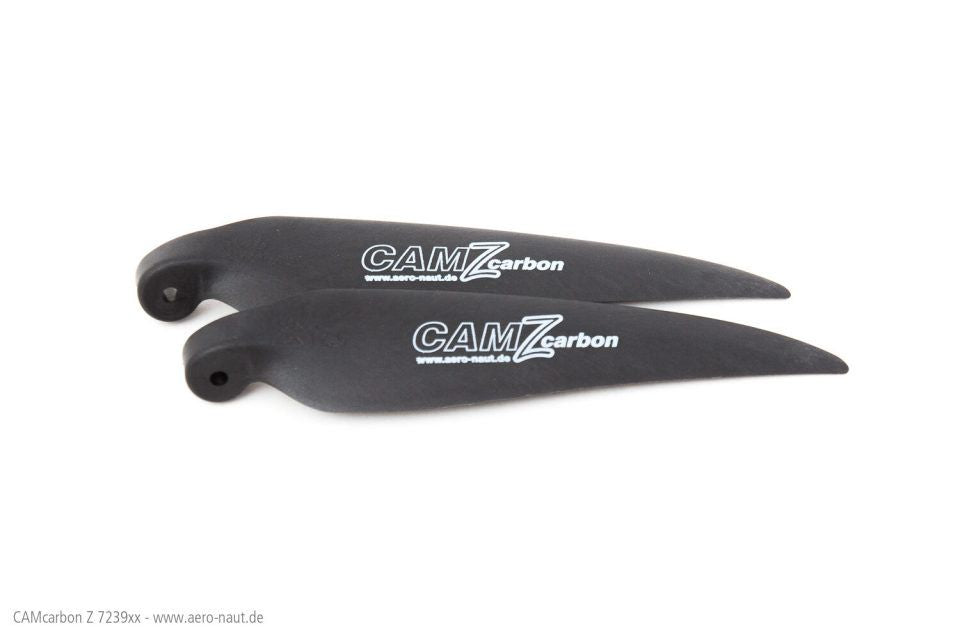

If using an 1100KV motor on 3 cells I’d look at 10x6 to 10x8 prop.
High performance Aeronaut blades are CAD designed, reinforced with carbon fiber, they have tremendous strength and efficiency.

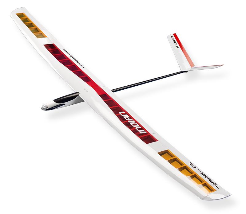

For about the same amount of money I'd look at these from Top Model.
These are usually just a step down in build quality from Pilot Models. I mean just ever so slightly less quality.
With gliders size does matter!
I like the Indian V as it has a "D" tube wing. I find they are easier to repair and that the airfoil performs better.

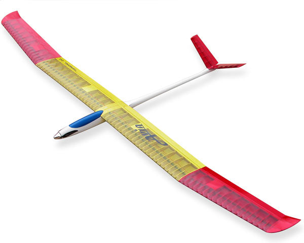

The Avia is great in that she is larger at 2.5m. But I don't like carbon tube spars and the distorted airfoil leading edge from the film sag.
Both are set up for full crow and trailing edge articulation and flap to aileron mix. Of the two I think the Avia might perform better for a novice glider driver.
Upon opening the box that contained the Indian, I was once again pleasantly surprised to see TopModels very good craftsmanship and build quality. All of the parts are individually wrapped or bagged; airframe parts, screws, control linkages to the firewall

Thanks for the follow up responses. Previously I had looked at the two Top models that you've noted. I liked Avia given that fact that it had a lower wing loading but at 2.5 meters it was too large. At 2 meters Indian was a better option but when I checked its manual, it looked as if the flap servo stayed in the fuselage which meant that the flap linkage had to be engaged every time the wing was bolted on. I find attaching a clevis very annoying especially if it needs to occur every time that I am at the field. As I write this, I realized this was another reason as to why I was looking for the manual for Chamomile as I did not know whether the flap servo stayed on the wing or not.

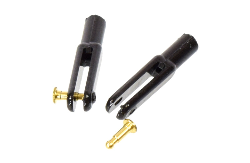

It looks like the Chamomile also has a fuse mounted flap servo. Can't say as I like the "L" linkage. but as the push rod in held captive by the fuselage it should work fine.
A viable option to the clevis might be snap on ball clevices. I wouldn't want to use these for primary flight controls*, but for flaps should they pop off in flight I don't think you would loose the airframe.
We found these especially useful for popping in and out the ball link control horn connections on V-tail slope gliders. You may find these useful as well for your own, "can't quite do it with needle nose" ball links.The pliers are of a mediocre quality but with patients, they do the job just...
alofthobbies.com
I also like the brass pin of the MP Jet clevis. Do keep a set in your flight box should (when) you drop/ loose the pin.
