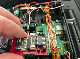

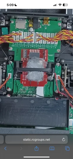

Hi guys I have a linker in my old taranus and now I run a X18 - can I make my own external module using the linker if I match up the pins?
I see the x18 has CCPM in trainer mode.
Regards,
Phil

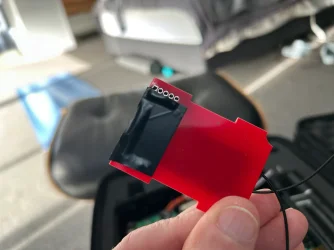

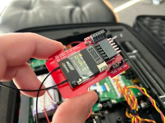

Here is the linker and the corresponding pins in the taranus - I think I just need to match to the X18 external pins?

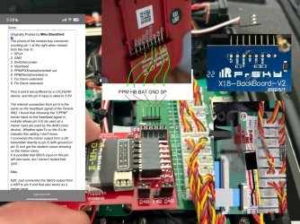

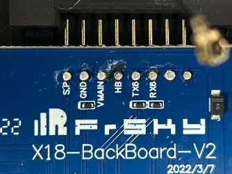

This seems to be the taranus module pinout - so I will try the configuration using the green connections to run the linker on the external module pins..
Pin 6 will be the CPPM in..
Will report back success or failure..

It will fail. Frsky made changes to the module bays, and Mike B wrote the code for the linker functions and had them added to OpenTX.
With this said, FrSky now has the built in wireless trainer setups. I personally prefer the Linker, it was fast and had a long range.
We just tossed out the last of the Linker Stickers and supplies a couple of weeks ago.

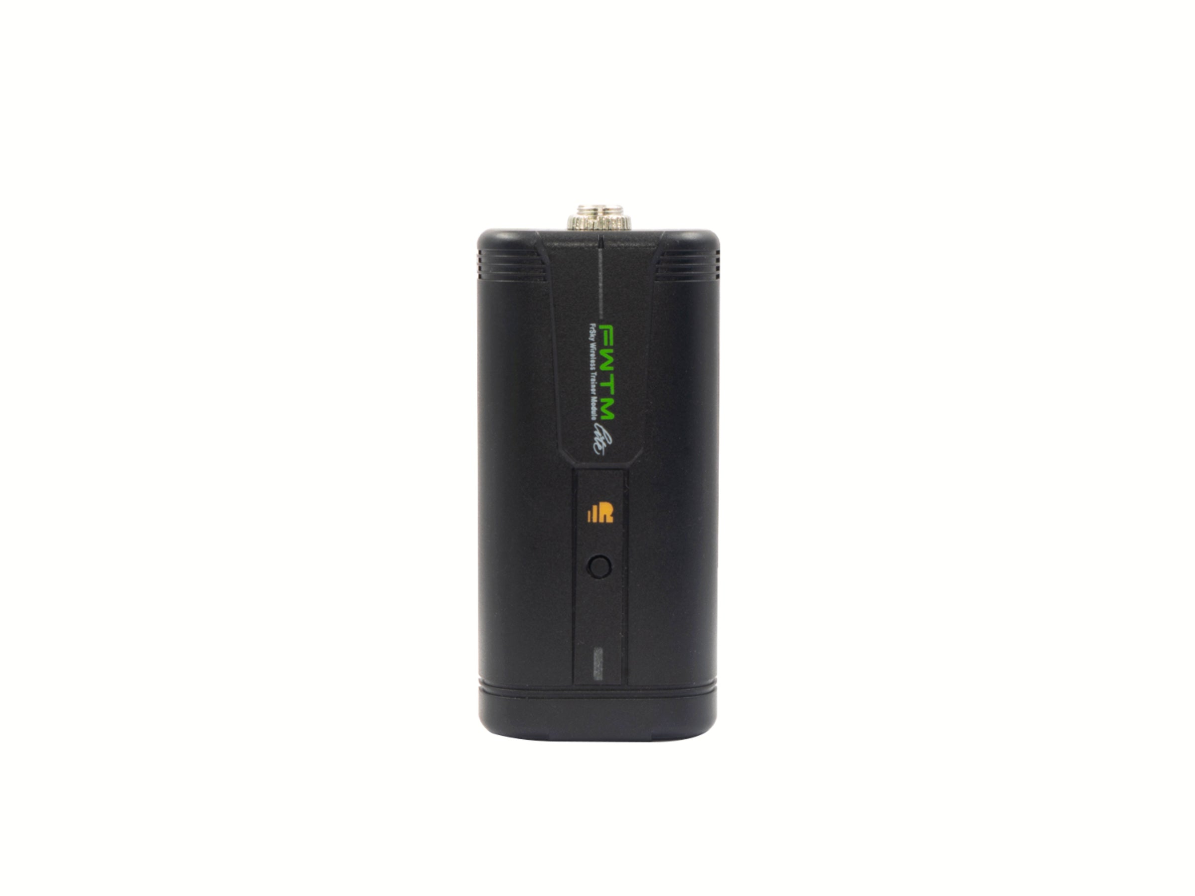

XLite did not offer the newer wireless training. The Xlite Pro was one of the first to offer that. You could use this:
