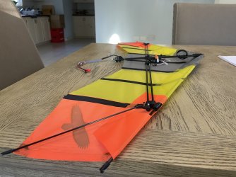

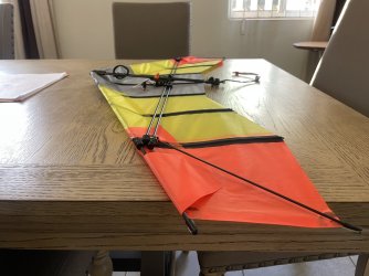

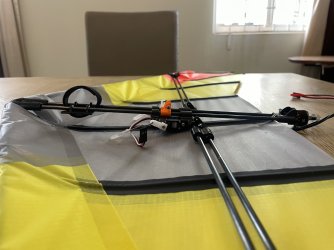

Started putting my Carbon Falcon Quick Build kit together today. I believe I’ve made some good progress, however, I am checking in to confirm I’m on the right path so far.
Just want to confirm the Torsion Rod Arm is correctly aligned. From the online manual it appears the Torsion Rod Arm should be somewhat straight up. As you can see mine are angled towards the leading edge. Tried to loosen the screws and twist straight but it seems to be glued fixed.
Help please.

Good morning, the Carbon Falcon Quick Build should already come with the torsion bars aligned correctly. All you need to do is place it on the table with the fabric up, supporting only the wing, not the fuselage. When adjusting the control horns on the EZLink servos, the wingtip should be between 65 and 68mm from the table. Measure this on both ends of the wing, adjust, tighten the screws, and you'll be ready to fly.
