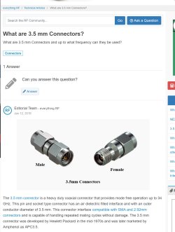

Konrad, it's been awhile since this post, but I wanted to bring you up to date and ask an additional question. I got my Schweizer 2-32 up in the air using the motorized dolly discussed previously. The model rose from the dolly and when it pulled away, the dolly motor cable came off as planned, the dolly rolled to a stop, and I had a successful flight. But here's the deal: It turns out that the cable connector wire ripped out of its housing, i.e. it didn't neatly pull apart. I didn't use a 3mm coaxial connector, but instead filed a standard servo wire connector down to where it almost falls out of the housing (well not quite - but very loose). In the back of the plane I angled the housing so that it's pointed down and to the back of the dolly where the motor and cable originate. So it's not like it's making a right angle when it comes off or anything. I can't figure out why it doesn't just disconnect without ripping apart. My question for you is about your recommended 3.5mm coaxial connector. That looks like a TV cable connector to me, at least the one I saw when I googled it (attached). Do you think that would work more smoothly? I'll probably have difficulties figuring out how to wire it, too. I was wondering if a small audio jack might work better.

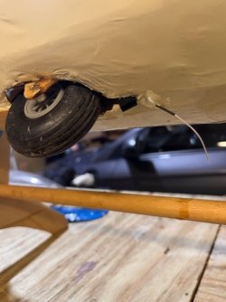

Unfortunately I got rid of the failed connector (I shouldn't have!). Anyway, here's a photo of where I glued the female servo adapter into the bottom of the fuselage. It's behind the wheel, pointing back at a 45 degree angle.

If that is the rear of the wheel then I think the connector is biased the wrong way. I also don’t like that antenna being so close to the ground and wheel. These little whiskers are rather delicate.
