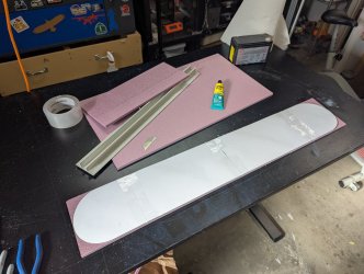

One thing I was struggling with for a while was how to get a perfectly cut hole for the wing to slide through the motor pods at the exact spot they passed through it. And then I remembered that I already had a perfectly cut hole from the original foam I cut it out of and I actually only needed to do a little bit of math and cut a rectangle out.

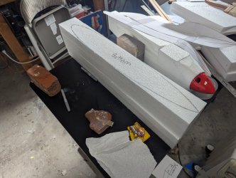

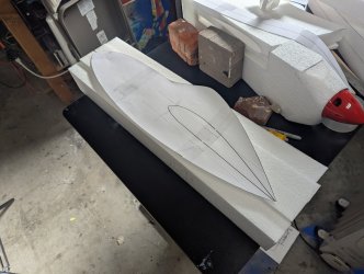

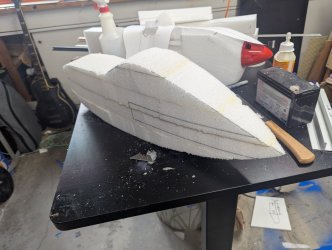

Looking good! I think you need to hold this thing in your hands so we can get an idea of what size your monster 38 really is.
I remember years ago a guy had made a fiberglass P-38 kit, and eventually he killed his flying sample, but even though he had the molds, he did not build a replacement. When asked why he stated he could not get excited about all of the fillets and sanding to make it look right. LOL It does have a lot of intersections with the wing and tail joints.
Yeah, it's a lot of foam. I'm going light on the scale. Like from the side profile on a flyby it will look pretty close but from the top view I have thinned it up a lot. The distance between trailing edge and tail will be the same. But will see how it goes on the fillets. If nothing else I may do some rubberized glue fillets everywhere as that will really stiffen it up. BUT since this will be covered I may end up covering the wing before it slides through the motor pods and fuselage. So then you know glue's not going to stick as well so I'm still thinking all that out.
"So then you know glue's not going to stick as well so I'm still thinking all that out."
If possible, just don't cover it at those places, Nate.
