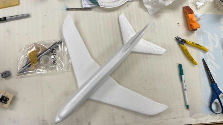

Anyone up for some FreeFlight racing at Sunset?
My new project - I figure we can all do a quick RC conversion and do a little pylon racing at Sunset?
I have a number of these little foamy free flights, 2 different styles. Anyone interested? Can drop it in the mail and should take a night to add some gear to it.

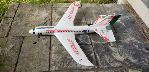

Just finished up Wayne's chuck glider for Sunset. I'll try it out at Tick today and see if it flies!
EDIT: I've not had success flying this guy - it always rolled to one side and crashed.
I'm going to convert to Ailerons and try again!
Oh nice idea. I was thinking it was going to have to have ailerons. Thats much simpler. Cant wait to see how it flies. Mind sharing the servos/battery you ended up liking?
edit: i see the servos now, looks like 9g?
Hard to tell scale of that thing from the pics. Maybe i missed the wingspan above? @Wayne
It's tiny - 19 1/2 inch wingspan.
used cheap 9g servos. I scrounged a 4.8v AAA pack - might be a bit heavy but I'll give it a try first.
I picked rudder elevator since ailerons or twist wing controls didn't seem very easy to do considering
how thin the wing is.

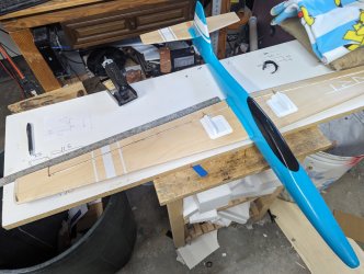

I'm rehabbing this 100" Ridge Runner, this one is a bit special to me.
A Boeing Engineer named Dave Katagiri designed the original 72" version. https://outerzone.co.uk/plan_details.asp?ID=6678 This one was blown up and built by Gary Hover for my friend Len Ledson. It was intended to slope race at the RCM Trophy Races which we now have come to know as the ISR in more recent years at Davenport, Ca. For whatever reason it wasn't flown much.
Len was a good friend of mine growing up. He is the guy who trusted me with several high performance glow models eventually culminating with me racing Formula 1 at the 1984 Nats in Reno, Nv, at 13 years old. We had many great adventures after that into the dawn of turbine jets before cancer took him too soon. For those of you old enough to remember he was half of the company Jim-n-IJjets, they had a precision scale all molded F-15 turbine model, T-38 others. They were quite the thing if you were lucky enough to get your hands on one. I purchased this from Len in the 90's. It sat around and I never did anything with it. It disappeared from where it was stored (long story) and to my surprise popped up on RCG for sale in the same condition as I last saw it. As luck would have it with the help of a couple of friends and @poh to mule it to me, I purchased it back.
https://www.rcgroups.com/forums/showthread.php?4245483-Can-Anyone-Identify-This-Ship&highlight=Ridge Runner
The model was built in March of 1975 and still retained its original Kraft radio gear. I'm keeping it as original as possible. I'm doing a servo swap only in the wings, even though the torque rod assembly is quite flexy, I'll live with it. The elevator on the other hand needs to change. It uses an all internal Nyrod (the yellow plastic stuff) and has more slop than I can stomach, so that has to go. I have a nice stiff 4mm carbon rod that I will run to an external control horn. I cut some of the Nyrod out, but most of it has to live in place. I need to laser cut a couple of servo trays, but it should all me done tomorrow.
