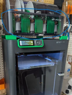

I honestly think printers should include filament dryers, they really are not optional. Ok, PLA doesn't hardly need it, but everything prints better when it it dried. We pretty much keep our filaments in dryers when they are in use.
The newer AMSs from Bambu and probably others do. I don't know how well they work.
