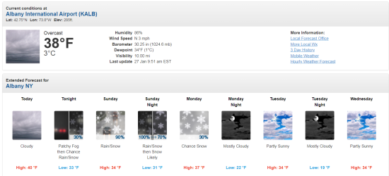

Cloudy day first flight.
Thanks, JOH, for making the photos.

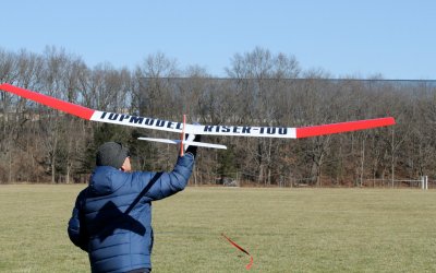

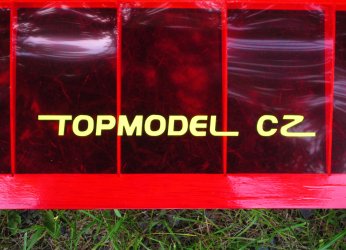

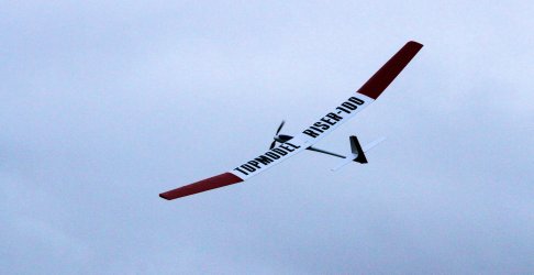

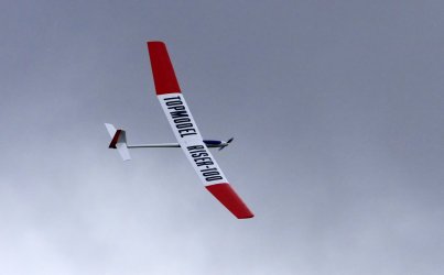

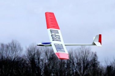

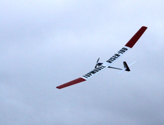

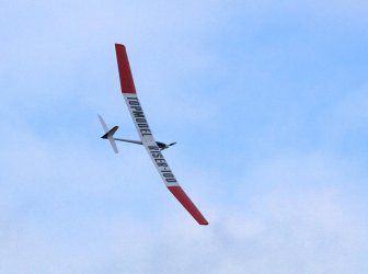

Looking good Dave
The graphics really stand out

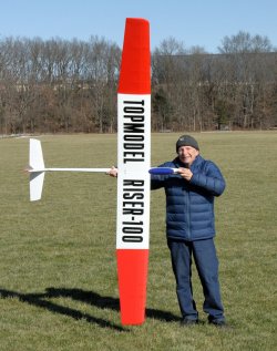

With the Riser wing, and stock Prelude rudder, did it feel like it had enough rudder authority?
Don
Don,
Plenty of rudder and elevator authority with the OEM parts. No worries there.
Man-o-man it really floats on that wing. No wonder it has been in production for 35 years.
Two flights with two battery pack weights, but I have not found the exact right balance point yet.
That and fine-tuning the control throws, then ready for flight test description.
I also want to assess the visibility of the covering scheme in the sunlight. Works pretty good on the gray day.
// Dave

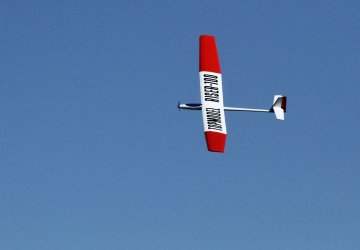

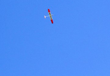

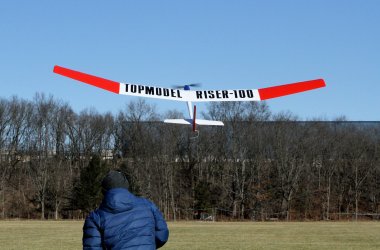

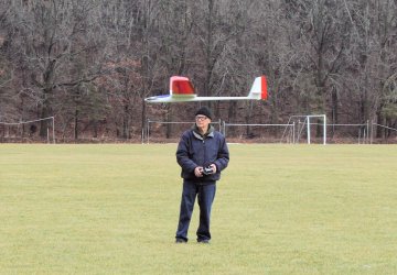

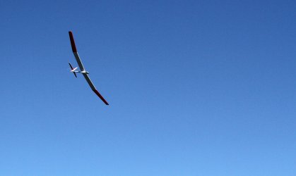

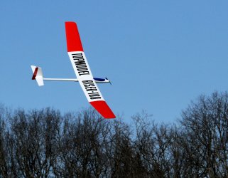

Got some sun today. Flew it on a blue sky day finally.
CG at 87 mm (3mm in front of suggested range.)
Lovely hands-off level flight, but dive test indicates still tends toward tail heavy.
I did not let it get fast in the dive test this time.
Thank you Jeremy for your work behind the camera.
// Dave

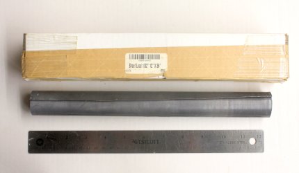

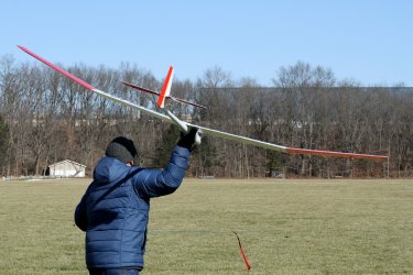

Dave - I was thinking about this and wonder if you might be willing to try something? I think you have way to much battery on these planes. With the rather heavy motor and battery combo, I think you are setting yourself up for flutter in models that have not fluttered for you in the past.
Since you have an "outrunner in a can" motor, don't be afraid to run a smaller battery and place lead up and round that motor to hit CG. Getting the mass as far forward as possible should greatly reduce the AUW of the model.
The weight reduction should result in a model that flies much better and needs a lot less motor, and we know, less motor means less battery needed. It could be a winning combination. Your flight times may actually increase despite a much smaller battery capacity.)
Please replace the 3S 3300 with something like a 3S 1300 and nose lead. (Woods metal is great for this sort of thing, I can melt the stuff with a covering iron! Just don't get any in the motor.)
I'd like to build one of the AH-100 wings with the Fuselage from the Harpia and power it with a rather light and low powered motor with maybe an 850 mah battery. Should be a real floater with that setup.
Wayne,
Sure, I will try reducing the weight and moving the remaining weight as far forward as possible.
- I have a shorter, lighter outrunner-in-a-can motor I can install.
- I have roofer's lead sheet which will form easily around the motor.
- I have smaller capacity battery packs to try.
A very cool experiment.
I do like the idea of planes that will float like a butterfly, dance like a ballerina.
// Dave

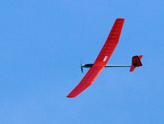

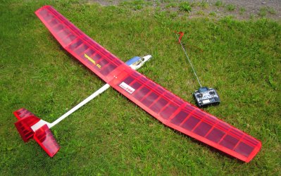

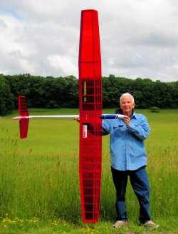

Red,
Yes, exactly so.
While it would trim nicely for straight and level flight, in the dive test it would speed up quickly and begin to tuck under.
This is particularly a mystery to me because my last RISER-100 wing on the PRELUDE fuse was wonderfully well behaved.
Unfortunately, that's the one (red clear covering) that I flew OOS in the Canadian wildfire smoke and haze.
// Dave

Full flying tail?
Yes, full flying horizontal.
That's supposed to handle this problem for us, right?
Things that make us go "Hmmmmm."

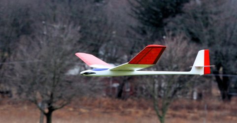

Crash, and Crash Again
Wayne> I thought you were flying a 3S 3300 battery?
For three previous days of flying, yes, a 3S 3300 battery pack.
But as a trial to reduce tail heaviness on Tuesday this week I grabbed the 2200 4-cell monster. It's a hefty one.
This practice, of course, moves in the opposite direction from what you are suggesting I try.
And it leads to a confession. I crashed twice in three launches on Tuesday.
First launch and landing: A-OK
Dive test showing some tuck under, but not as much as previously.
Moved the battery pack half an inch forward, snug to the back of the motor.
Second launch, flying for the camera - turned while too low and slow and piled in from 20 feet.
Broke one nylon bolt, no other damage observed.
Replaced the bolt and relaunched.
Third launch, flying for the camera again, but trying to be more attentive.
Even so, I got too low and slow with the heaviest 100-inch floater I've ever flown and piled in again.
This time broke both nylon bolts, a folding propeller blade, and knocked the servo mounts loose.
OK, done for the day with that plane, but here's the important point:
NO DAMAGE AT ALL TO THE TOPMODEL PRELUDE FUSELAGE.
NONE.
NONE AT ALL.
Even under very careful inspection on the bench today, not one bit of damage can be found.
It took me 48 hours of pondering to decide to admit this online.
I do not mention this to showcase my meager flying skills and poor judgement.
I do it to assure builders that the Topmodel PRELUDE supplies a TOUGH FUSELAGE.
For the balsa bashers among us who have seen split, crushed and fractured fuselages, be not afraid of a FIBERGLASS fuselage.
This fuse is stronger than you'd think.
Keep on Rockin' guys.
// Dave
