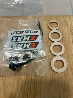

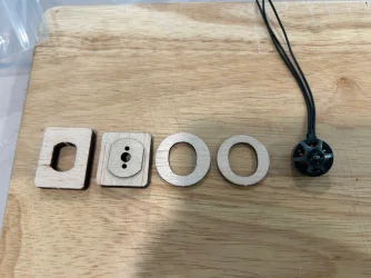

I chose the brushless motor kit but the instructions show an older version of a brushed motor. I need some direction on how to finish out the nose and install the brushless EMAX ECO Micro 1404
motor. I've attached two photos, the first shows the nosecone pieces that came with the kit, the second shows the four pieces that came with the motor. Any advice would be appreciated!

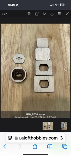

Thank you Tom, I'm assuming the actual mount is the plywood piece? I've laid the parts out in order from left to right in this photo, does that look correct?

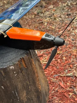

You use the two that came in the wanderer kit. See photo. The bottom two in your pic. These get glued on to the forward bulkhead. When you push in the plastic motor mount you will notice it has a lip that stops it from going any further. Then the balsa rings in the motor kit go over that to take up the space between the spinner and the motor mount. I only used one. Hope that helps. Also mine was a tight enough fit that I did not glue in the motor mount. That way I can pull it out if I need to remove the motor.

Got it thank you Tom. The plastic motor mount that they included was actually hiding inside the spinner in the plastic bag. It makes sense now. Appreciate it.
