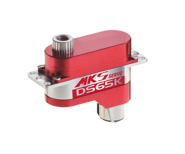

I'm not aware that KST and MKS have anything (yet) in the 4.5 gram class of servo. The MKS DS65K is in the same size but at 50% more weight and 5 times costlier it is out of the running as a replacement for the BMS 101DMG.
The Dymond D47 is in that 4.5 gram class but it is larger and does NOT have metal gears. What I love about the D47 is the side clearance for the wire lead. I'm not aware of anything in the 4.5g class that comes close to the BMS 101DMG. Ether in the single cell or HV power class. If we go much smaller in size we start to see the horrible open linear servo.
The BMS 101DMG is not in the same size class as the MKS HV6100, KST X0-8 or BMS A10.
