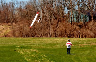

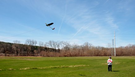

We got some air under the wings of the FIRST using a bungee yesterday.
It is a very pleasant flyer, I will say.
More nimble, and better hang time than I expected at this wing loading.
A magic airfoil, perhaps?

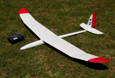

Is it my screen? But it looks like you have changed from a natural wood finish (in snow) to a white (in grass). Is this a varnish or iron on film? If iron on did you have any concern with the heat going through the thin veneer? But then low heat iron film would negate that fear.
I too really like the airfoils, sure a lot better than what we had in the Wanderer days! Back then I loathed the 2 meter as a TD ship. Today I'll actually try to compete with the standard and larger class ship if all I have is a 2 meter. With some luck (bad on their part) I can often do well with the modern 2 meter.
That is rattle-can spray paint. Dark blue on bottom, white on top.
While the Blejzyk natural wood finish has its charms; for me, max visibility is vital.
I like the durability and ease-of-maintenance of paint over film when there is a choice.
Two light-as-possible coats of Minwax Polycrylic added 0.2 ounces / 6 grams.
One coat of spray paint, top and bottom, added 0.8 ounces / 23 grams.
The balsa tail parts are covered with heat-shrink film.

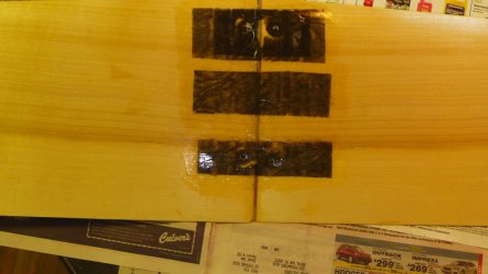

also i mucked up drilling holes in wing getting the collets? to fit, counter sink
gave up cleaned up holes packed them with
West will try using slightly larger dia. screws without the collet ?
will post photos when have camera cable

Ahoy again
found fiddly cable
see photos
yours truly
mac
