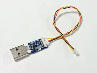

I was just hoping you could confirm, that what you are saying is that an RX62H-F2 (ACCST V1 version) can be updated/converted to an RX62H-F3 (ACCST V2 version) by just flashing new firmware? I would think so, since the hardware should be the same. If it can be updated, by "programmer" do you mean the MxUSB-PG02 usb tool (see attached)? Thanks!
