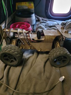

Batteries are up front so, in this case, I think, maybe...just maybe..it a time to just max it and see. Might keep me from giving her a lead nose. 5000 MAH ordered :)
If it's too much, I have another gizmo that can use it.
