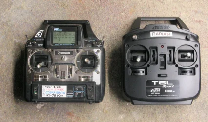

My personal solutions have been:
1. Refit old favorite and familiar transmitters, 72 mHz Airtronics VG6000 with FrSKY 2.4 internal conversion modules
purchased from Aloft Hobbies (in days of yore) and from RC Groups classified ads. Now I have a familiar 6-channel
computer radio with internal antenna which links to inexpensive and reliable FrSKY receivers. The VG6000 holds only
four models, which led me to refitting multiple transmitters. Plus, I like having a spare transmitter when I sally forth.
2. Recent purchase of a Futaba T6L very simple beginner radio. Mine cost $99 with a full range receiver included.
It takes four AA dry cells, which is my favorite way to power a transmitter. The transmitter comes from the factory
bound to the receiver. All you have to do to run rudder and elevator is plug the servos into the correct slots.
If you want to run a motor you must reverse channel 3 or you will be in for a surprise. (Futaba oddity)

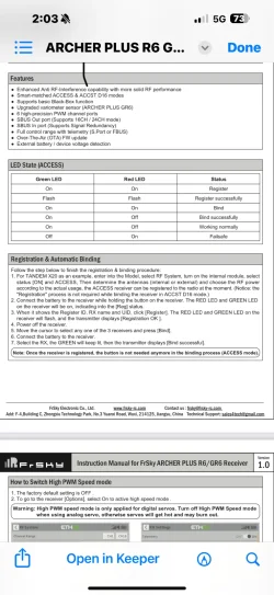

Yes, I hate the little registration buttons on the receivers. Some are darn near impossible to push. For sure you a power switch to make it more reasonable to accomplish.
“For sure you a power switch to make it more reasonable to accomplish.”
And why ?
See instructions on registering and binding. You have to push button and turn power on and off. I found it hard to hold the button while plugging power connection into third space on the rx. Switch makes it much easier and will have many uses down the line. Like if you have plane powered up on your work bench and need to turn it off fast.
