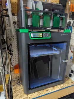

Spot to discuss P1S, parts we are using. Upgrades. What filament we like/use.
Our favorite MODS and UPGRADES:
Brighter better placed LED light. Magnetic connection, uses same connector as included light:
Poop Chute
AMS Desiccant holders: https://makerworld.com/en/models/545051-bambu-lab-ams-dry-boxes-desiccant-silica-gel-beads
Desiccant from amazon: https://www.amazon.com/dp/B01I5Y2DG6?ref_=ppx_hzsearch_conn_dt_b_fed_asin_title_1&th=1
Funnel for above: https://makerworld.com/en/models/463978-funnel-for-ams-dessicant-holder
Top Glass riser: https://makerworld.com/en/models/506696-upper-glass-riser-also-works-with-ams
My shop is regularly over 75f so i use this all the time
