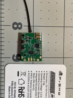

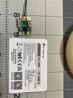

Hi there, I’m a total newb setting up my first kit. It’s a Micro Gentle Lady which I’m outfitting with the Archerplus R6 Mini. Being a newb I have no idea where to connect the power to the receiver and frankly I couldn’t find any guidance in the instructions where the power terminal is located. I see the +\- terminals on the back of the board, however, the instructions call this terminal 6 and make no mention of this being the power connection. Please help!

Yes, it is the +/- terminals, and yes, the third pad there is the signal line for channel 6. It is not very clear in the instructions.
For reference, instructions from FrSky:
chrome-extension://efaidnbmnnnibpcajpcglclefindmkaj/https://www.frsky-rc.com/wp-content/uploads/Downloads/Amanual/ARCHER%20PLUS%20R6%20SR6%20Mini%20Manual.pdf
If you are not going to use the ESCs, then you should be able to power by one of the other channel plugs as micro servos will not draw much power at all.
