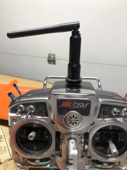

I am looking for a new antenna for my JR X9503. Seems the only thing I can come up with is DX6 antenna's when I do a search. :/
Wondering if I can even get a new one any longer.
Is this a 72 MHz system? Is there something unique about the mount? RF waves don't care about the plastic. So from an RF point of view just about any antenna of the same length and design (metal parts) should work.
Chances are good that the Taranis Antenna would work well for your radio. Very similar cases...? Show a picture of yours..
Here is a pic

Is that a converted radio or is that stock. Seems like that is screaming out to be damaged. We could maybe convert your radio over to no antenna. I'd have to see what connections they use inside, then an Xlite antenna inside your case. Otherwise you will be at the mercy of Spektrum for a repair.
