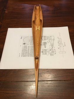

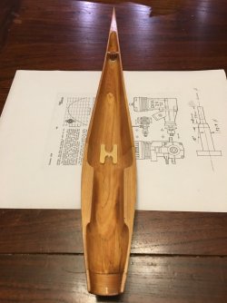

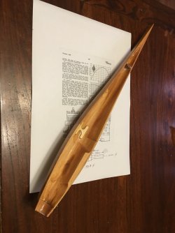

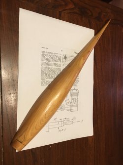

This is a Pattern I carved for a new control line .29 speed pan. It will be cast in Magnesium or Aluminium.
Sometimes its good to put a sharp hand tool to some nice cedar.

That is Real Control!! One gets a real visceral connection with C/L. None of these waves or radiating connections.
