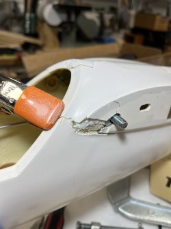

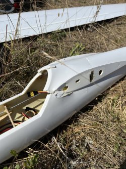

Last weekend I succeeded in doing precisely what I’ve been trying not to do. I botched the landing at Tick pt. Totally misjudged the approach speed and the bottom fell out as I descended into the slower air while slowing down too much. The nose dug into the hard pack in the LZ and the Alpina came to a complete stop in about 2”. Looks like the anti-crush brace that sits in the fuse between the wing’s LE popped free which allowed the wings to pinch forward. In the video you can clearly see the point where she stalls and pitches forward.
Good news is that it doesn’t look so bad now that I’ve gotten things back into alignment so at this point it’s just a matter fiberglass repair across the fractures
Some of the bigger fractures along the back of the canopy opening were displaced on impact and their jagged edges intermeshed to make it impossible to realign without sawing through the jammed areas. Once they were freed up I was able to push some of the fuselage back into position. The biggest point of crushing was the port side LE with the wing root from the wing joiner to the LE folded inwards a few degrees. I used a 1/4-20 bolt with threaded couplers to make a spreader bar to push the port side back out.

I put a piece of Birch ply at the front and another the rear of the wing on mine (3) many years ago. As I remember it extended about one inch in front of the wing LE position and the same at the back but about one inch behind. Loads of room to do it and I had seen many crushed in that position. It worked well.
Actually, this an inherent problem with a front/rear-flexible blade joiner. Great in vertical stress, but very poor in horizonal
Also, on an Alpina its a good idea to make a pretty sturdy and long radio tray to bolster up that boat of a fuselage. Mine was two laminated layers of 3/16" Birch ply and extended from the very front to way past the leading edge of the wings. That also provides some more support in the event of a sudden forward moving wing.
Heavy? Yep, but thats great - better to have strength-adding payoad than useless lead up front.

Yes, the CS calls for an anti-crush brace between the LE in a separate addendum to the instruction booklet. The design also has a plywood brace spanning the fuselage near the TE.
In this instance, looks like my anti-crush brace popped out on the hard landing. Probably insufficient roughening of the inside of the fuselage where the failed brace anchor was epoxied, so this will have to be addressed during the repair.
If I didn’t have a brace at all, the damage may have been more severe.

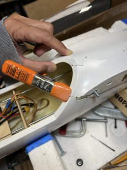

Repairs have finally resumed! With the fuselage cracks aligned and stabilized with epoxy/cabosil earlier, I’ve now marked the cracks and outlined a region to sand/scuff that I can actually reach from the inside. Shining a light on the outside of the fuselage backlights the cracks as seen from the inside. A small mirror on the floor of the fuselage helped me see the areas on the underside of the top of the fuselage immediately behind the canopy. A Dremel right angle attachment with permanent grinding wheel just fits through the canopy opening and into the repair area.
