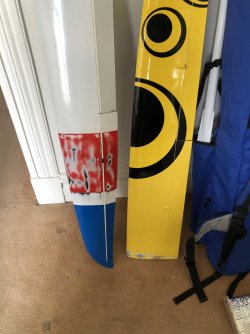

Well painting didn't work out well. To save weight I did not use a sealer. I put down PPG Delfleet Essential top coat directly on the sanded surface. Only to find that the TJIRC red pigment had floated through the paint.
