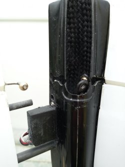

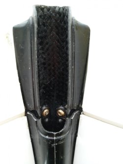

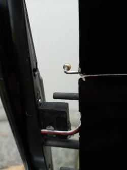

I've been flying a 'Great Wall' for a good few months and can report on its character. I used Servorahmen frames and IDS along with Kingmax servos in wings (from Flightech, I'm in the UK) and have plenty of fast, slop-free movement and long travel on flaps for great control on landing. After a while I fitted servos with linkage inside the tail and did away with servos in the nose and the long pushrods, works really well with zero issues. Flies like a dream and it's quick. For ballast I use brass in the round wing holes, nearly 300gm total, and steel in the joiner, about another 600gm. CG around 97-98mm behind leading edge is neutral.
The photos above were taken while fitting the servos into the fins but after they were fitted and working I realised that it is better to have the servos, wiring and linkage attached to the fuselage rather than the tails. The fixture of the tails seemed firmer after the fitting also. The ball joint needs pulling off the ball before a tail is removed but then it pulls straight out. I like the little JX servos I used in the tails by the way, they are HV for 2S, dual ball bearing, quick and strong enough for elevator and perhaps ailerons, thin and don't cost much! I'll pull a fin off tomorrow and take a photo to show the servo sticking out from the rear of the fuse.

Redbird, your installation looks clean! You mention attaching the servos to the fuselage, do you mean keeping the same position/orientation of the servos, only fixing them to the fuselage tail instead of gluing them into the tail fins?
@Redbird the more I look at your solution to the V-tail the more I like it. I think I'm going to copy your set up. But with the threaded L bend in the servo arm. I'll be trying for a very short arm, like 4.5mm long.
Einar, thanks, it seems to do the job well. You've got it with the servo fixing. The servos are not that cheap! Plastic case must help. I wouldn't task them with racing ailerons in a mouldie (though the PDI-HV2107MG could be alright) but they are the right size, speed and power for the tail mounting and I find they centre well. I am using them with four wires for the pair, 22 guage I think. I have a pair in the nose of a Mini Q as well.
Konrad, feel free. Good luck with the short servo arm.

Showing one JX PDI-HV0903MG servo attached to fuselage at the tail end of the TJIRC 'Great Wall'.
