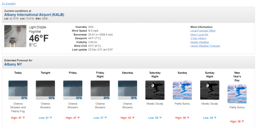

And we wait for some clear skys for flight testing.

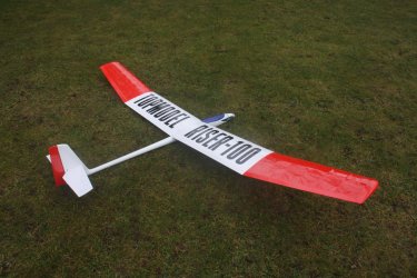

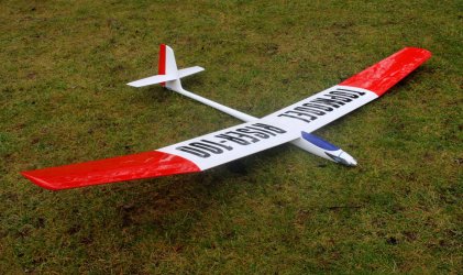

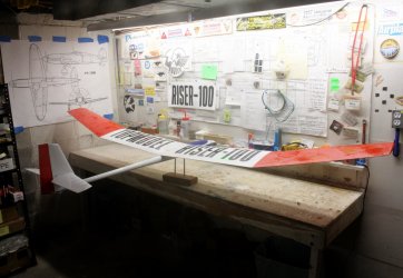

Stick a fork in me, I'm done.
With the motor, ESC, and servos I had on hand, and a 2200 3-cell pack,
the CG settled smack dead center between the 90mm-98mm from LE that Sig recommends for the RISER-100 wing.
I go now to start on the build thread:
BUILD THREAD: Sig RISER-100 wing on Topmodel PRELUDE fuselage
That's a really nice look G-man. Should be a fun fly.
John
Thank you John.
Since I flew my last one out of sight in Canadian wildfire smoke and haze, I was going for max visibility on this one.
I was inspired by an OLY-2 photo I found on the internet.
Dave, job well done.
I'm really inspired to finish up my identical build.
Having Dave's build thread to follow, is really helpful.
The Prelude/Riser combo looks like the real deal.
Don
