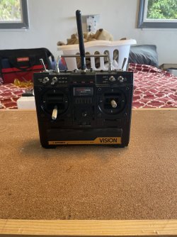

Hello I’m trying to convert my old airtronics vision 8sp to 2.4 preferably spectrum since those are the receivers that I have. Any ideas will be help full.

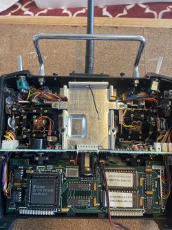

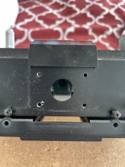

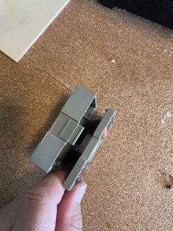

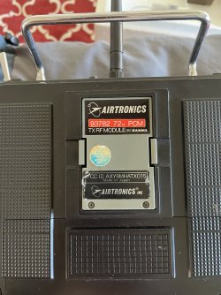

Here is where I’m at with my conversion.
Bought a lemon rx 2.4 dsmp jr bay moduel.
It didn’t fit so I took it apart and making it fit. Here’s some photos . I need to find the pin out for my vision xmiter and my Lemmon module. Before I let the magic smoke out 😂😂😂

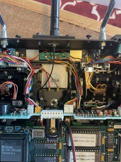

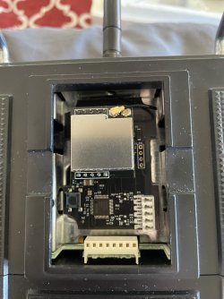

Here is where it’s at now chip installed with two sided tape. Old gray case cut to fit. Just needs wiring up

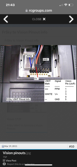

I could use some help. From this point of the conversion. I wired everything up , according to the pinouts I could find.
I can’t bind to my reciver . Got power thru the pins. Here is the oinout I used

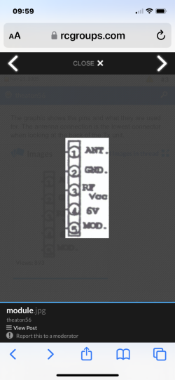

This photo is the pinout I used from my lemon rs jr bay compatible .
Gray is my signal black is my ground orange is my power.
