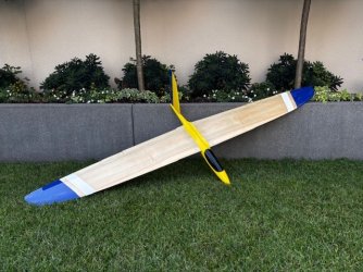

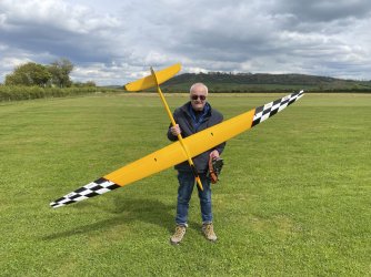

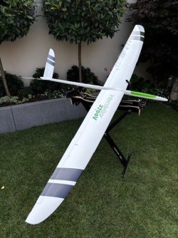

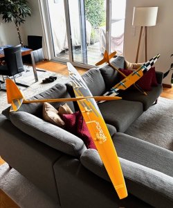

As far as my back ground and experience, I would call myself an intermediate sport modeler. I got into aviation via modeling as a teenager. Once my career took off and life captured me, I got away from it. My professional back ground includes military and airline - CH47 Chinook and the last 28 years flying the B747 as Capt.
I’m an American, living in Germany - my German wife won’t let me return home. I fly alone and am not a member of any club. I live in the Mosel wine region. Many nice (vineyard) slopes, but difficult landing areas - particularly for my modest skills.
In addition to the SS Forza and SS Senssanta (purchased strong versions due my landing conditions), I’ve built and semi mastered the attached models.
I’m still researching components and building plans for both the Aeroic models. I’ll use KST servos and fly a Jeti DS12 (fully unlocked) radio system. Other than wing ballast in the Forza, I don’t think I’ll install ballast tubes - I’m an old guy and will only fly in relax conditions. I’m also leaning towards installing the rudder servo upfront with only the elevator aft on both models. No clue on type of push rod for the elevator. Not sure what type/size battery I’ll go with.

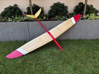

Hunje, at this past Sunset flying event I was able to purchase a prototype version of the Sessanta from @Wayne. I didn’t get the chance to fly it due to limited time and didn’t build it so can’t offer any insight in that regard. But if any pictures would help, @thenated0g has it at his house in California and can post some.
