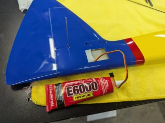

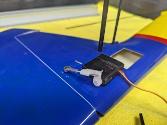

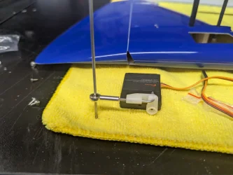

Kyle and I were discussing our mutual love of e6000 and how we have switched from using epoxy on servos, while at sunset the last day. He showed me the premium stuff (red tube) which i had never seen so i grabbed some. He said its even stronger. I dont know if you have ever tried pulling apart this glue it its pretty crazy on "normal". This stuff does have a smell to it though whereas i havent noticed it on the regular.
