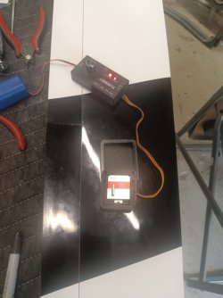

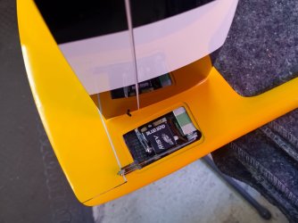

Servo installation is coming along nicely. I would recommend 8 or 9mm servos in the tail but you can make it work with stuff that is a little thicker as I have done. My elevator servo is 10mm and the rudder one is 11.9mm. I used Tomas Liu linkage for the elevator but I'm sure you could do something with a z bend and a ball link.

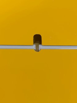

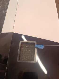

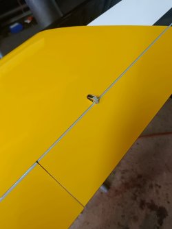

Here's the wing control horn installation. I use a rotary tool mostly and some of those permagrit type files to fine tune. I had the clevis on the horn when I glued it in. That way I know for sure it's in the right place.
After the horns are glued in, I made sure they allowed full movement. I had a little epoxy get in the way of the hinge on one so I popped the clevis off and cleaned it up with my Proxxon. That's like a Dremel but in my opinion, so much better!

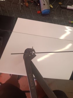

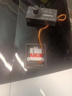

Next screw a pushrod in, move the control surface all the way one direction and mark the pushrod. I used tape. Then I move it the other way and see how far it moves. I measured about 10mm of travel on the flap pushrod, so that's how I know where to put the hole in the servo arm.

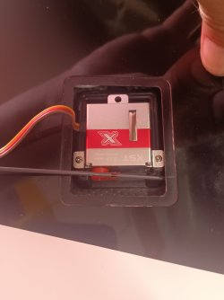

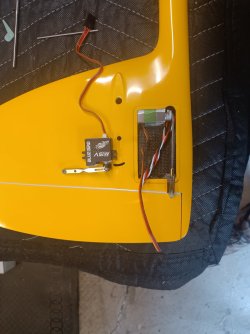

Drop the servo in the hole and mark the pushrod again to see where to put a z bend in it. With these short throws, you either need a z bend or something like Tomas Liu linkage because it allows you to have the hole really close to the output shaft of the servo. A regular clevis will hit unless you grind it out.
Once I dry fit everything to make sure the length of the pushrod is correct and the servo arm position on the spline is right, I flip it upside down and apply thickened epoxy on the bottom of the servo tray. The z bend is already hooked up on the servo, so once glued up, fip it back over and into the hole. I have a servo driver hooked up so I can move it if needed. Have some paper towels and some alcohol handy to clean up any mess.

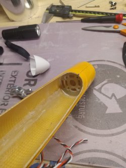

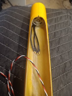

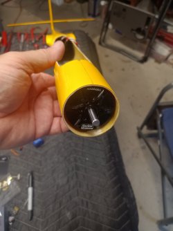

I chose a Hacker A30 12xl that was in my cabinet. I like to mount outrunners on the back so I pushed the shaft out the other end and cut some G10 for a mount. It's drying overnight using West System G flex epoxy.
Once dry I added pics with the motor in. Mounting this way keeps all of the spinning bits in front so the battery and wires can't get caught up in it.

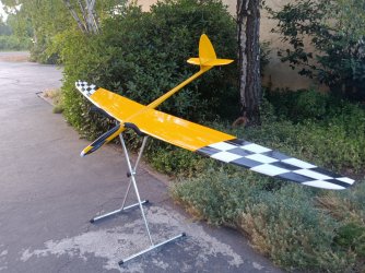

She's ready to fly.
Probably would have been done yesterday but my tx had the little button cell go bad so I wanted to take care of that first. Had to go to 5 stores before I found a cr1220!
Today the weather is nice and cool so I'll get out in a bit for some flights.

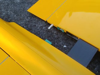

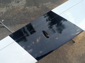

The mpx style connectors are epoxied in. I do the fuselage ones first using the other side to hold it square till it dries. You want to pull it off when the epoxy is firm but not rock hard in case you get any where it doesn't belong.
The wing servo covers get trimmed and taped on. I taped the motor wires along the side of the fuse with blenderm and the esc is in the back so I have lots of room to adjust the cg with the battery. I'm using 4s 1800 and a 14x10 prop.

Very nice! Should fly like a bat out of heck.. LOL I loved the speed the Corsa carried in glider form, this should be the same.
Interesting motor mounting. Agreed on keeping the wires out of the way.

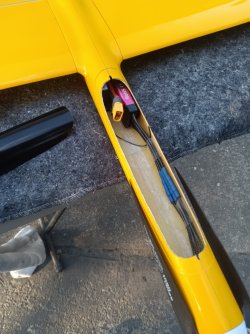

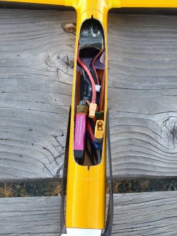

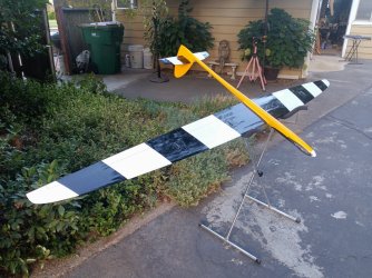

Working on electric Sessanta today.
Some changes were made. I moved the esc to the front and put a 4s 2200 in the back. The servo wires are sitting along the bottom of the fuselage with some tape over the top to keep them out of the way. I installed a 13.5x7 prop and this turns out to be a great combo. It will climb nearly vertical.
