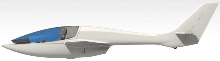

Looking at what is available: I.e very few actual internal engine gliders - and what are flown with vectored thrust - which are normally large scale jet models, its easy to get mixed up. Added to the confusion are the piggy backs which most who have tried will tell you can a be a bit hard to deal with.
This is not a large twin-engined jet scale type model with vectored thrust.
Its a smallish 2.8~3m GLIDER model with a small internally mounted jet engine and vectored thrust - if desired.
From now I'm going to forget EDF and just concentrate on the Jet Turbine options
For a jet glider you dont need overkill in the power to weight department. Although if you listen to half of the pilots they will recommend outlandish sized angines. I was advised 7kg thrust for a 3M model for example.
A 3m model should only weigh 3 to 3.5Kg if made well. Light, stiff and strong. Maybe this is a hangover? The only Italian aerobatic glider models I have seen have been amazingly heavy - but I dont know why. They seem to use a lot of resin to make the job fast and easy I guess.

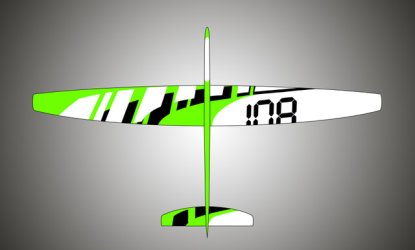

I'm seriously thinking of designing a lowish aspect ratio model - like my Aresti for example which is highly aerobatic - basically an Ahi type arangement. This would be about 2.8~3m span, around a single 4.5Kg Jet Turbine unit (which could be bigger if required) and a thrust vector unit. It would have intakes as far from the deck as possible, and a fixed or retract undercarriage - in the right place. Very likely a V-Tail - just to be different I'll admit - but that's not cast in stone yet.
Basic specs:
2.8~ 3.0M Low aspect ratio, high wing area "Ahi" type wing.
4.5K engine with a short nozzle to thrust vector option.
Fuselage designed to be a glider type but with a jet engine and an undercarriage (retract or not)
Maybe V tail.
Really good powered or unpowered aerobatic potential.
Hopefully good looking
This is where I am so far.
More suggestions?
